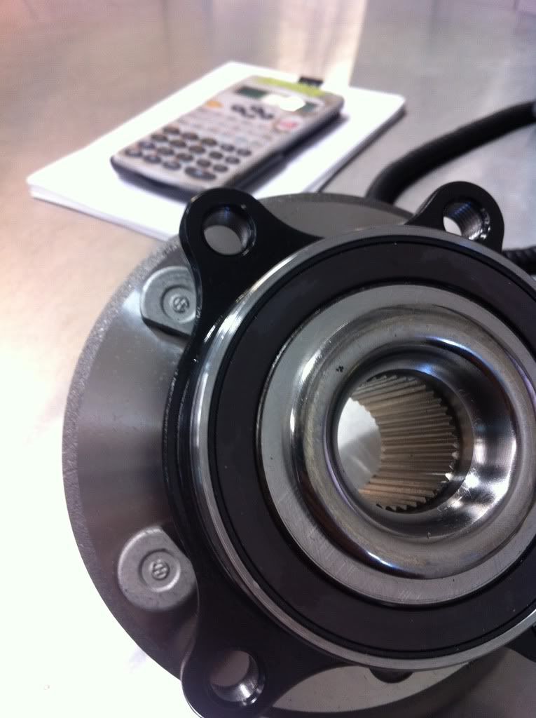

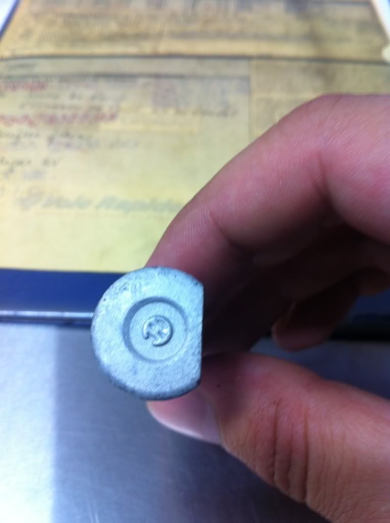

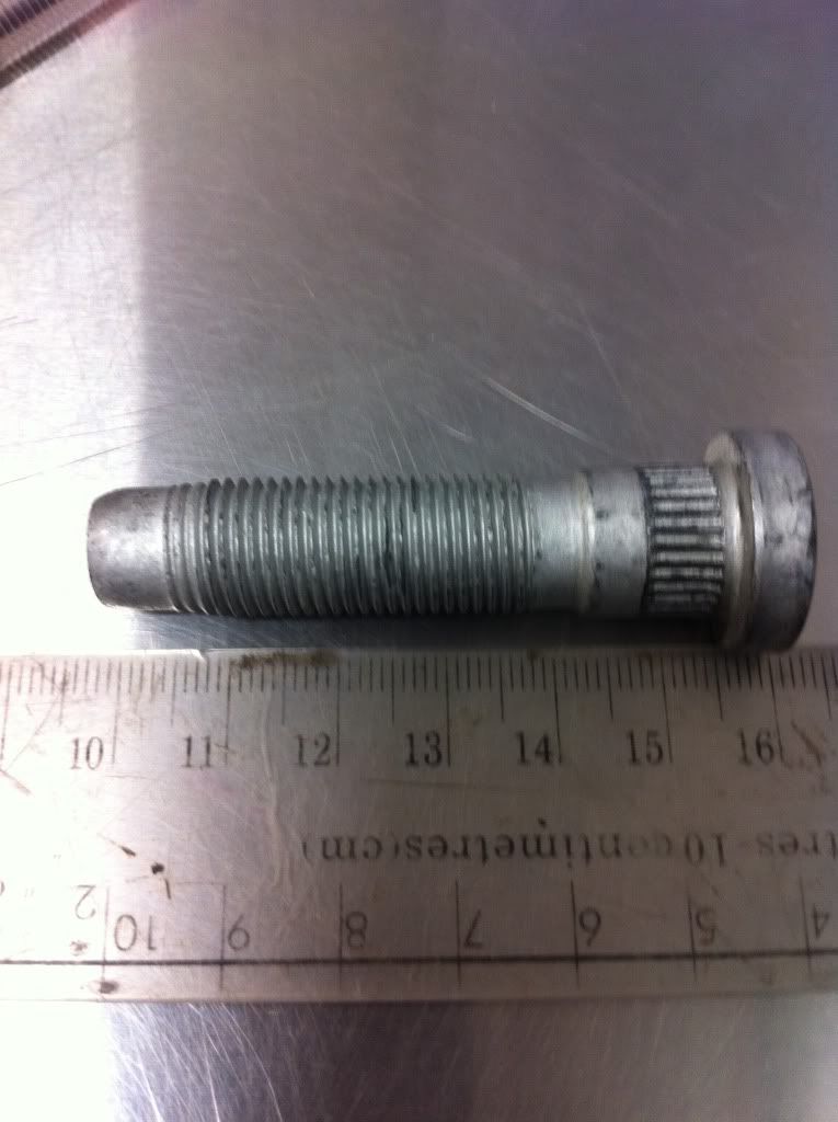

Wife's cousin order an hub assembly as it wasn't in stock. Got back ordered then was delivered during his vacation. This morning, he had some spare time so he dissemble one stud from the hub assembly, measure it and took pictures:
1/2-20 RH 60mm long, 30 grooves on the knurl, all the same 20 studs for the 4 corners
Now I need to find longer aftermarket studs that fit with my 8mm spacers.
