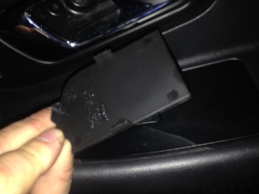

next will remove panel from behind door handle. Using a small flathead screw driver pry into the very top over the top tab will pull right out.

Now the 2 10mm bolt from under window switch plate and from behind door handle cover.
