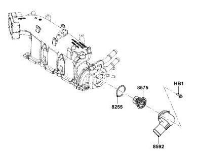

Hey everyone. Long time. So, i removed my intake manifold on my '11 flex EB to get to back valve cover, and all reinstalled i noticed my over flow tank over flowing and bubbling so i thought bad t-stat. So i got new one from oreillys, looked nothing like the old one but i tried it anyway. Then when i started the car again the radiator fans were stuck on high speed and coolant started leaking out of t-stat housing. I assumed pressure was building up behind this t-stat i just got from oreillys because it wasnt opening due to it was a 190° and i heard the flexs OE is like 170-180° and also plus it looked different. So i brought it back, went back home and tested the old original one using the pot and water boil method. T-stat opened just fine right before boiling. So i put it back in with new t-stat seal and a dab of water sealant. It was fine for the start, fans were on super low speed (but still on which i found weird), no leaks, but as soon as i drove and came back it was leaking again. I noticed a hairline crack on intake side. Could that be it? Did i possibly torque bolts to housing to tight and warp it? And also i noticed no gasket between housing and manifold, normal? Sorry for long post. All help needed. Thanks.
