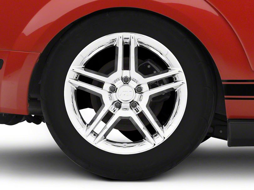

Yeah I am sort of going opposite of everyone and looking to brighten the wheels with polished/alum rather than black them out.  This is the set I found local...

Pic is too small...which wheels? These?
or these?

DOH!  Sorry about that, here is larger image, looks more like the top one.

Looks like those are either a RTR wheel, AMR , Forgestar, or one of the many variants of that style. Those are NOT GT500 wheels.
Check if they have a ford stamping on the inside of them if you go to look at them. If so then they are likely the RTR wheel, though I'm not sure what size those are. If they are OE ford wheels, that is still a steal assuming the tires are in good shape. If they are reps it isn't as good a deal but still a pretty good deal depending on tire condition.
If they are not ford stamped, and ff the tires are 50-75% used up, then $600 is too much for reps. I would say go with an RTR rep or the American muscle AMR (https://www.americanmuscle.com/silver-amr-wheels-1013.html) at that point. You'd be in it ~ 600 for 4 brand new AMR wheels from American muscle with lifetime structural warranty, and a year of finish warranty. I loved my AMRs in gloss black on my sho, though I ran em in a 20.
With mustang wheels, remember, the offset is a little different and the wheels will not look identical to stock SHO wheels with regards to the wheelwell location. Bolt patern is the same though. You would likely want to go with a different tire than stock size for a mustang 18, look up the PI wheel size, or the SE/SEL taurus 18 wheel size, I don't remember it off the top of my head but either/both of those should work just fine. You can also do a tire size comparison between your stock size and whatever size you are looking at.

Those are some aftermarket center caps, not OE as well, so those don't add value on that set IMO.
The wheels are reps, but not even GT500 reps, seller doesn't really know what they are, and just put that due to the center caps most likely (A LOT of cragislist mustang wheels get listed as the wrong style because people are told something wrong, or they have a different center cap, and people don't know)

Those are the 2011/2012 GT500PP style wheels. However, I believe the Fords only came in a 19" charcoal tint.
Get pictures of the inside of the rims, if they happen to be Forgestars jump on them quick, otherwise pass on them. :)

IIRC the 2011/2012 GT500 PP Wheels have 8 sets of pockets,
while from what I can see of the pics OP put up, there are only 7 pockets, which is why I went for RTR/RTR Rep/AMR etc.
