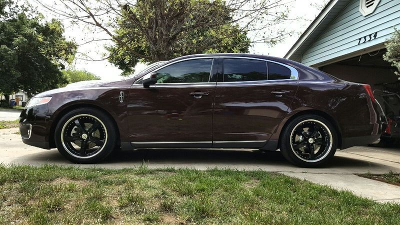

so I scored a set of TSW Jarama 20x8.5 40ET really cheap ($270 for all 4) and wrapped them in Nitro Motivo 245/45/20 rubber. I'm still trying to let the look grow on me but meanwhile having a hard time getting this thing into learn mode for TPMS so I can reset with the tool. Any tips on doing so ?
