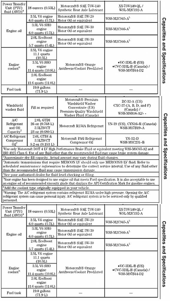

Hey guys, I wanna do the oil change for the ptu but not sure where to start. How much and what weight oil does it take? Where are the fill and drain plugs?

BiGMaC said:Here are the Capacities and Fluids from the 2013 SHO manual, 3rd printing, pages 365-367 :ford:: PTU is near the bottom
