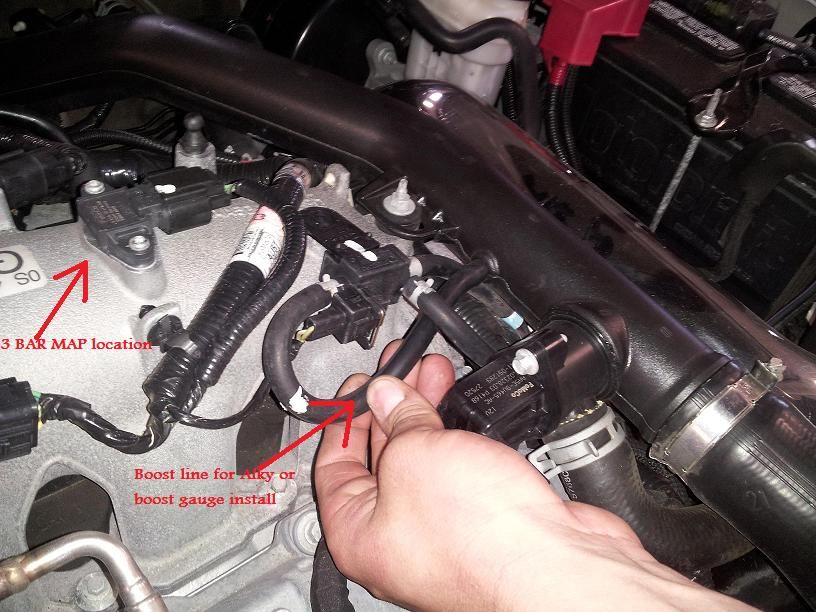

They probably hooked it up between turbos and throttle body so it will not experience vacuum.
For it to read vacuum and boost it needs to be hooked up to the intake manifold.

This is wrong information.....you simply need to tap the vac line from the intake manifold

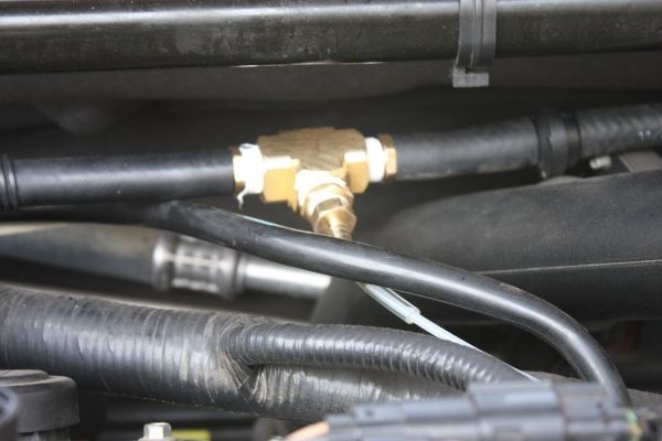

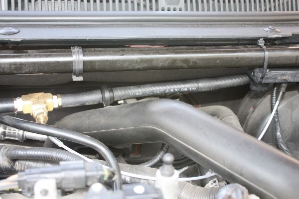

Tapping into the brake booster line against the top of the firewall will read both... Here's pics
Below is where LMS taps for boost guage, but not sure if it will show vacuum.... I know the brake boost line above will show both.
Well i have my gauge hooked exactly where u said as im writing and im only reading vac, no boost. And yes, my connections are tight with no leaks. Mind u, i have a flex so the SHO may be diff. I run 2 seperate gauges. Yes i know its dumb. I hate it. Lol
WOW....You have it set up wrong....All you need to do is grab a line that comes from the intake manifold....You probably are hooked up to the brake booster line after the check valves.
