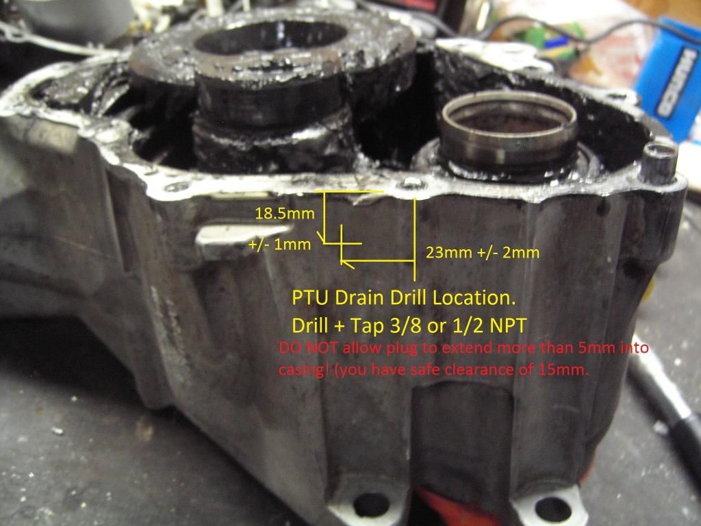

I am preparing for my tune by changing all my fluids again and my 3 week old ptu fluid looks like it might have dissolved some of the sludge. So now for my question has anyone put a temperature probe into one of these cases? I found where someone did the drain plug so why not slip a sensor in there? Or am I missing something?

No reason not to do it as long as the sensor doesn't stick into the PTU gearing... Follow the diagrams for drilling the PTU that are posted here. Just FYI, the pics and measurements posted are the PTU from an Edge even if it's the same part number... and I am unaware of any long term F/U... So installing an auxiliary cooler might make more sense if you're going to drill the casing.

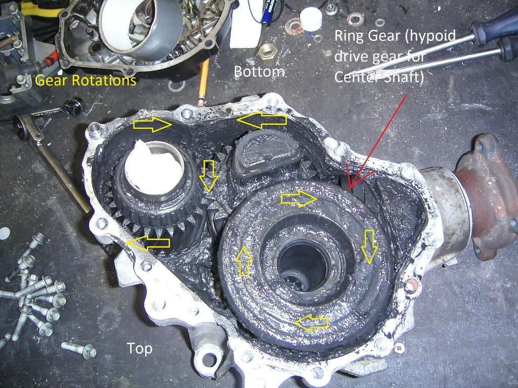

Well... There's a lot of picture and stories showing either burned up PTUs or PTUs full of black semi-liquid that is the consistency of near frozen chocolate syrup at 20-30K miles.... Many don't have an extended warranty. Ford has a MTBF of 100K miles which will be past any warranty for most.... At 300 degrees in a non-PP how long can a couple of ounces of gear lube last? ...or in a PP that's driven in a spirited fashion.
I agree with replacing the unit entirely if it fails.... But why not PM it to prolong the life? My dealer won't do it because Ford won't warrant the part if they do...
Here's some pics of the PTU... First 2 are what a lot of folks find, third is where the PTU has been drilled for a drain or guage, last pic is what the first 2 should have looked like...
