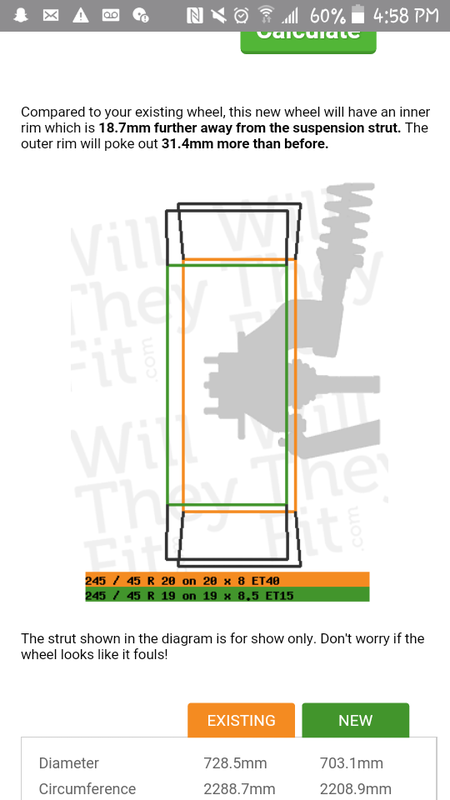

I want to do 19 inch rims. Not exactly sure how the offset works. And what would happen if somebody got it wrong. Dumb it down for me. I like these 19x8.5 thoughs... dam

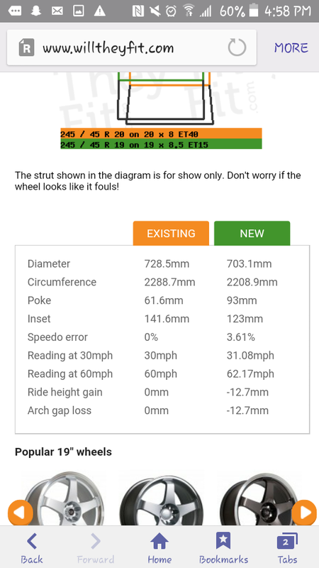

This is what "will it fit" showed me when I typed in the new wheel in contrast to the stock ones. Lemme know what it means guys haha
Would not be even close.
Generally speaking, you need a 35 or so offset.  Most critical is bolt pattern.  Only a 5x114.3mm (5x4.5") bolt pattern will work.
That tire size is also probably not a good choice. I would stay within 3% or so variance.  You can look at the speedo error for that percent.  Those tires would leave a large wheel well gap even if lowered.
