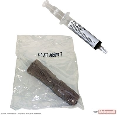

Well unfortunately the trans tech confirmed its the TC.  He said its not bad and suggested some snake oil.  Thoughts?
He said there is a TSB or something for the F150.  They use Motorcraft XL16.  He said it is 2 part and only use the maroon tube.  ever heard of this?
XL16 appears to be a transmission fluid modifier, while XL17 is an engine oil modifier.  I don't think XL16 significantly different from the Lubegard Shudder Fixx in its' function, and so in theory, it should work if the problem is in its' early stages.  Could be worth a shot if you are out of powertrain warranty/don't have ESP warranty.
